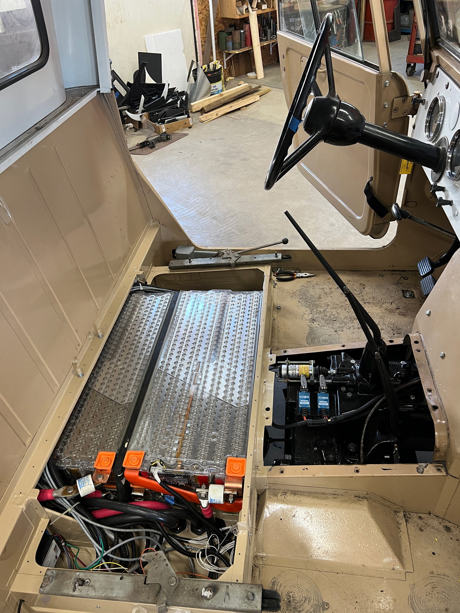

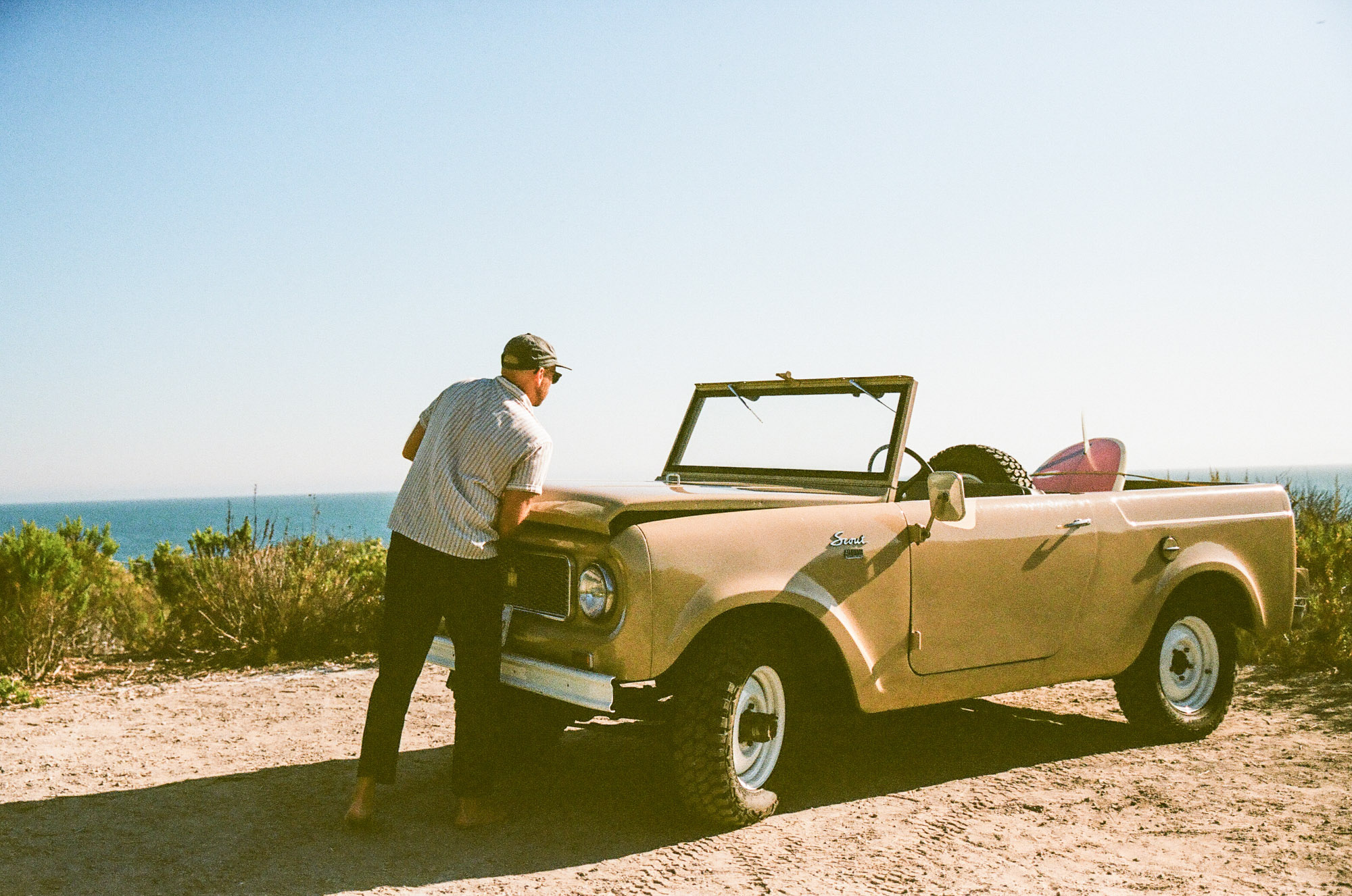

“I wanted to keep the truck looking as stock as possible. This meant we had to try to hide 12 batteries. Figuring out where to put them, and how to get them there was challenging.”
Matt bought a run-down 1961 Scout 80™ from a family who didn’t even realize their Facebook Marketplace listing was still live. It didn’t run well, it leaked fuel, and after driving a few miles would get stuck in gear. But that didn’t matter: the combustion engine was never meant to stay.

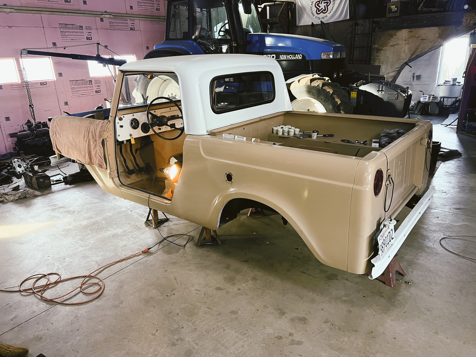

Matt shipped the vehicle out to his uncles’ farm, left his surfboards at home, and joined them for what he hoped would be a month-long build. It turned into two grueling months of 12-hour days in the dead of an Iowan winter, immersed in wiring, battery systems, and drivetrain conversions.

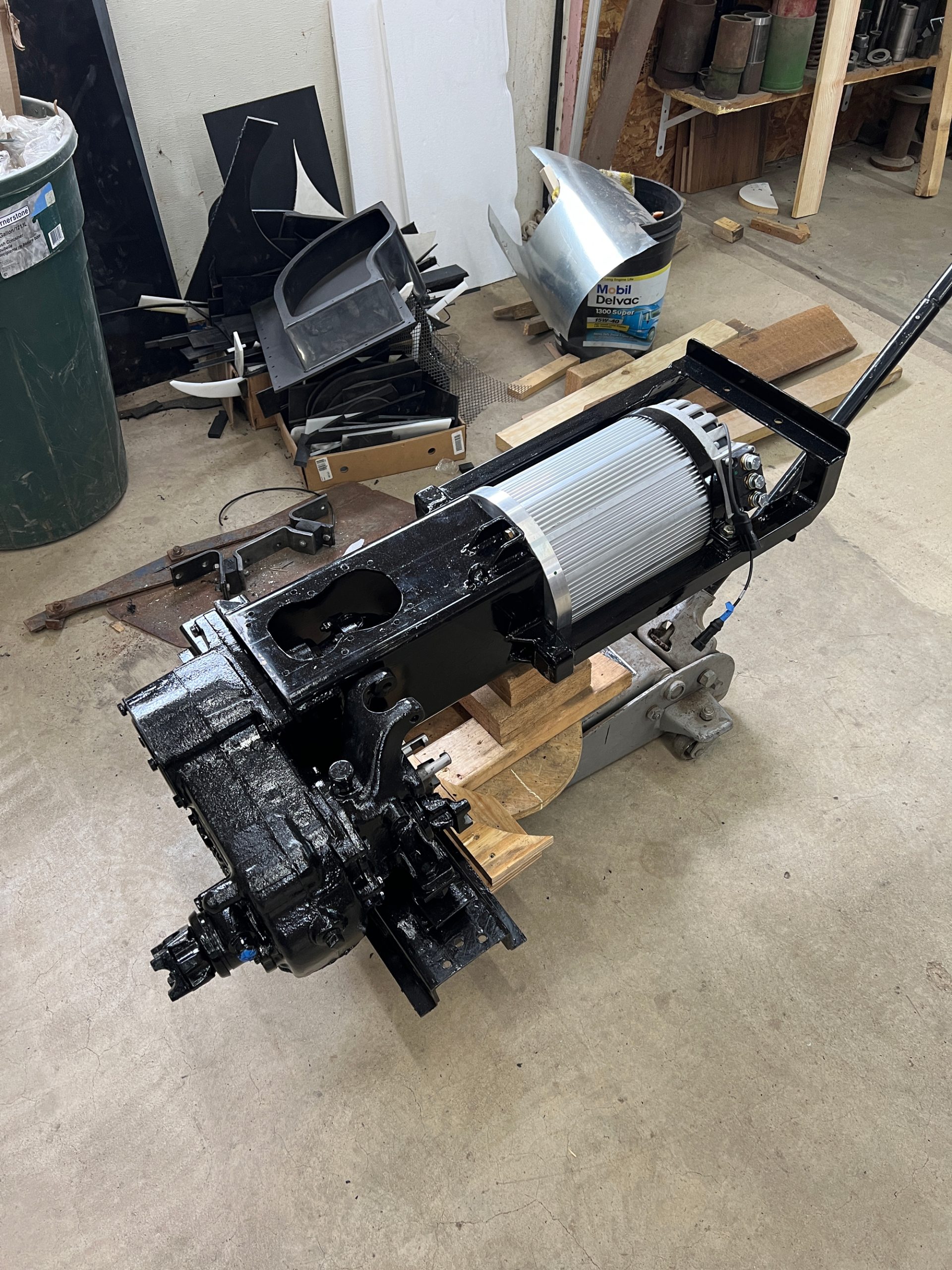

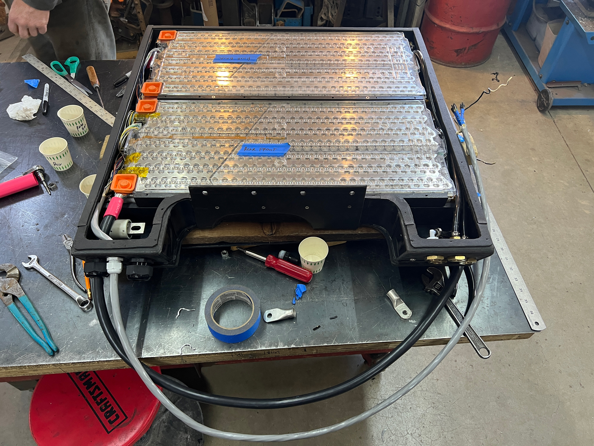

The heart of the Scout 80 is now a HyPer 9 HV electric motor, which has a peak output of 90 kW and a solid 162 lbs.-ft of instant-on torque. It’s hooked up to Tesla Model S batteries which he purchased back in California—even meeting with the seller to test them before committing.
“I wanted to keep the truck looking as stock as possible. This meant we had to try to hide 12 batteries. Figuring out where to put them, and how to get them there was challenging.” Matt’s Uncle Paul used his plastic welding skills to build three custom battery boxes.

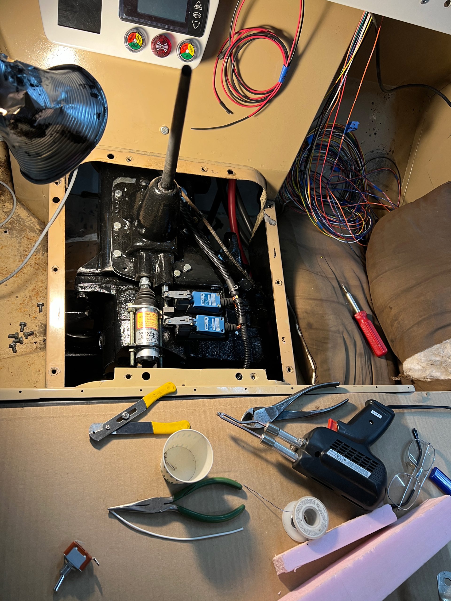

Most of the control and charging ancillaries are new though, sourced from the Santa Rosa specialist Thunderstruck Motors, and there’s a Netgain display so Matt can keep an eye on speed and battery charge. The crew at San Marcos-based EV West helped from a distance with advice and troubleshooting.

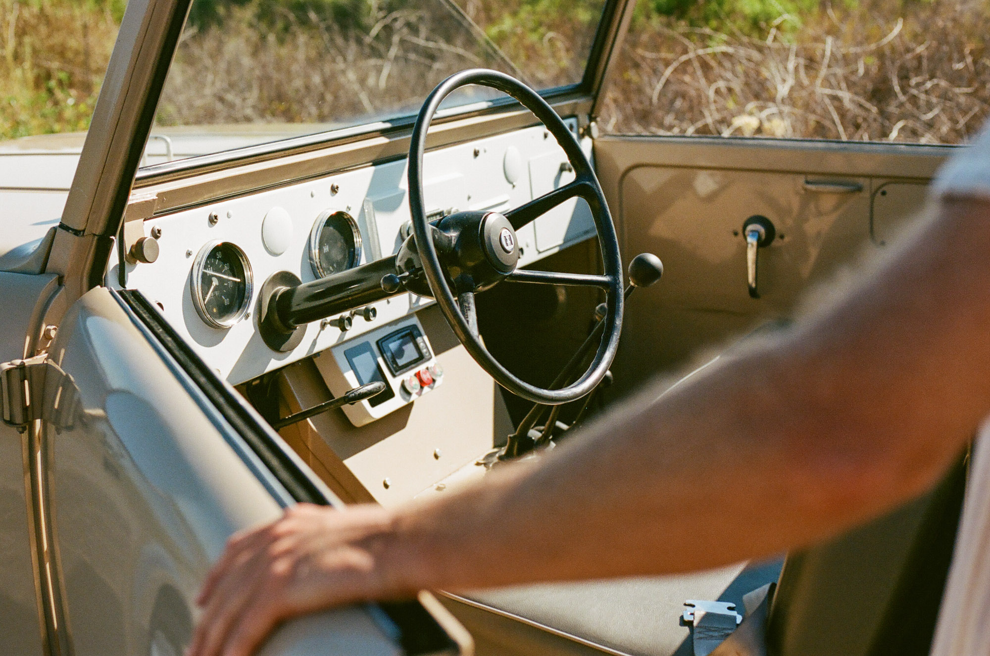

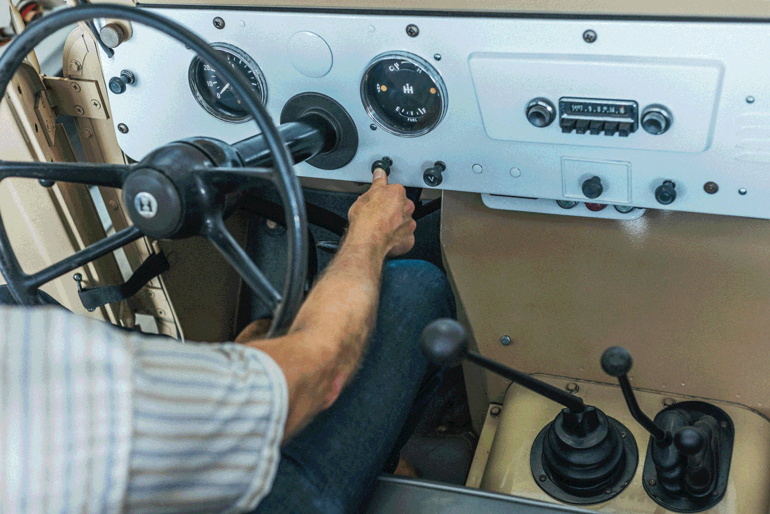

The control systems were hidden behind a telescoping dash panel, designed by Paul to keep the vintage look intact. “It drives like a Scout,” Matt laughs. “Quirky, noisy in low gear, sometimes stubborn. But having it still feel like driving an old Scout truck is part of the charm for me.”
The biggest issue was connecting the electric motor to the existing drivetrain. “We installed an aftermarket off-road drive shaft yoke on the transfer case. My uncle used his Fox Super Shop lathe to machine a repurposed taper lock pulley to connect our EV motor. Because we connected through the transfer case, the truck still has four-wheel-drive.”
