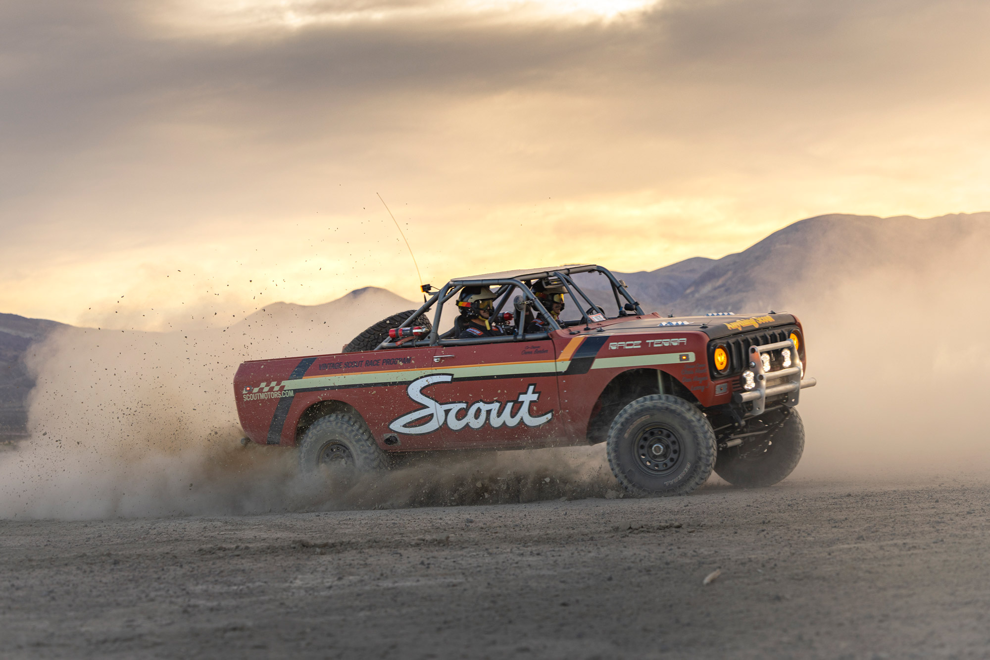

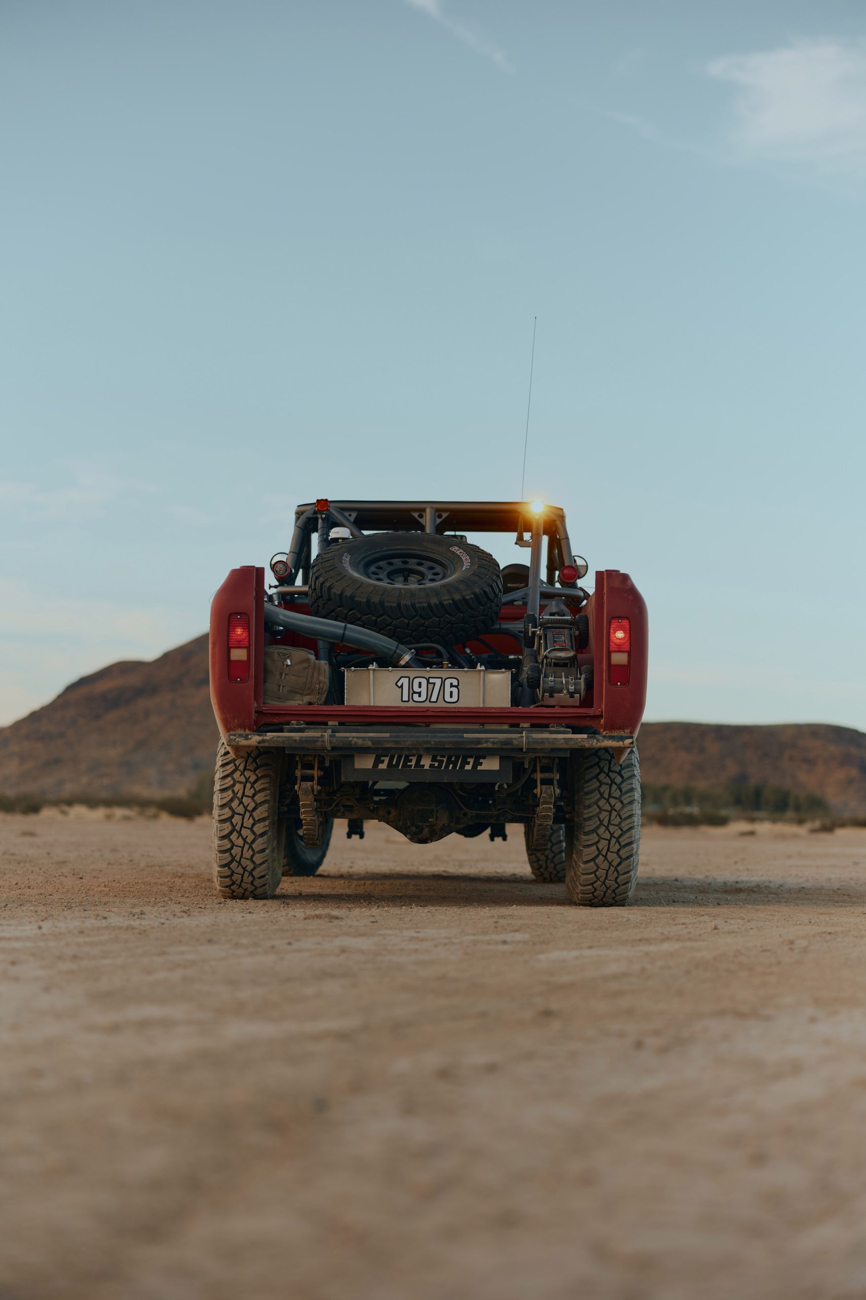

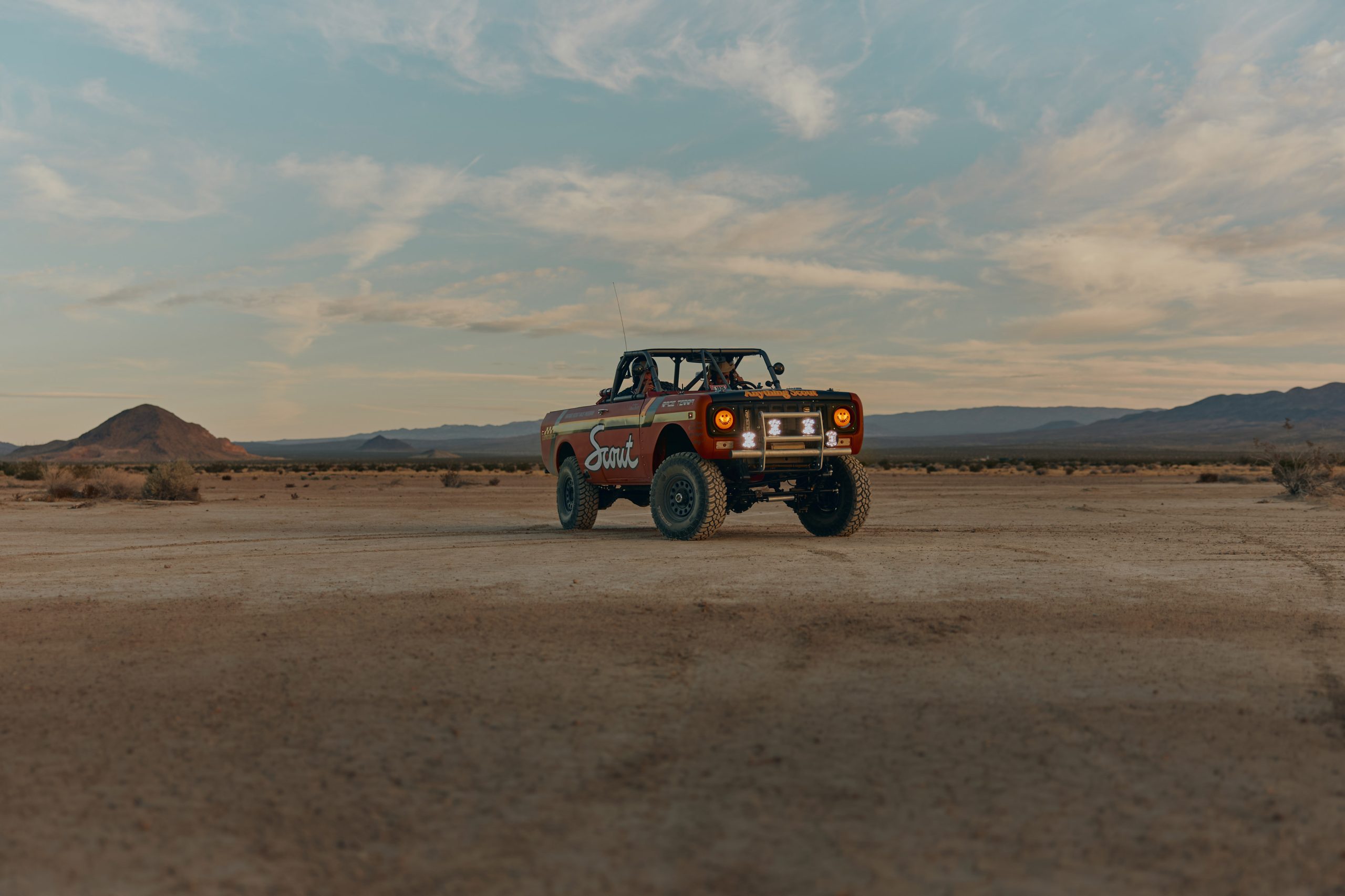

Sometimes it pays to stick to what you know, so Sean is racing his Terra again. The Race Terra has been rebuilt and upgraded and once again, it’ll run in the Legends 4×4 class. “It’s a great class with good competitors and cool rigs,” says Sean.
“We loved how the Terra performed, and it was tried and true and saved our lives. We wanted to carry that same spirit into the new Scout race truck.”
This year’s Race Terra 2.0 is the latest in a long lineage that goes back to the original, factory-sponsored race trucks. And once again, Scout Motors is providing support, knowledge, and camaraderie.
Sean’s inspiration comes from former factory Scout racers such as Sherman Balch, Jimmy Jones, and Frank Howarth, plus privateers Jerry Boone and Russ Kirkpatrick.
“I took particular inspiration from Byron Rexwinkle, the talented builder behind the Sherman Balch race trucks,” Sean explains. “I own Sherman’s last Scout race truck—I studied it closely and replicated as much of the design and techniques as I could.”
Sean describes the rebuild as “a heavy team lift.” He’s especially grateful for the generosity of Jeff at the IH Parts America® store, who donated a new body and frame, and even a spare engine.

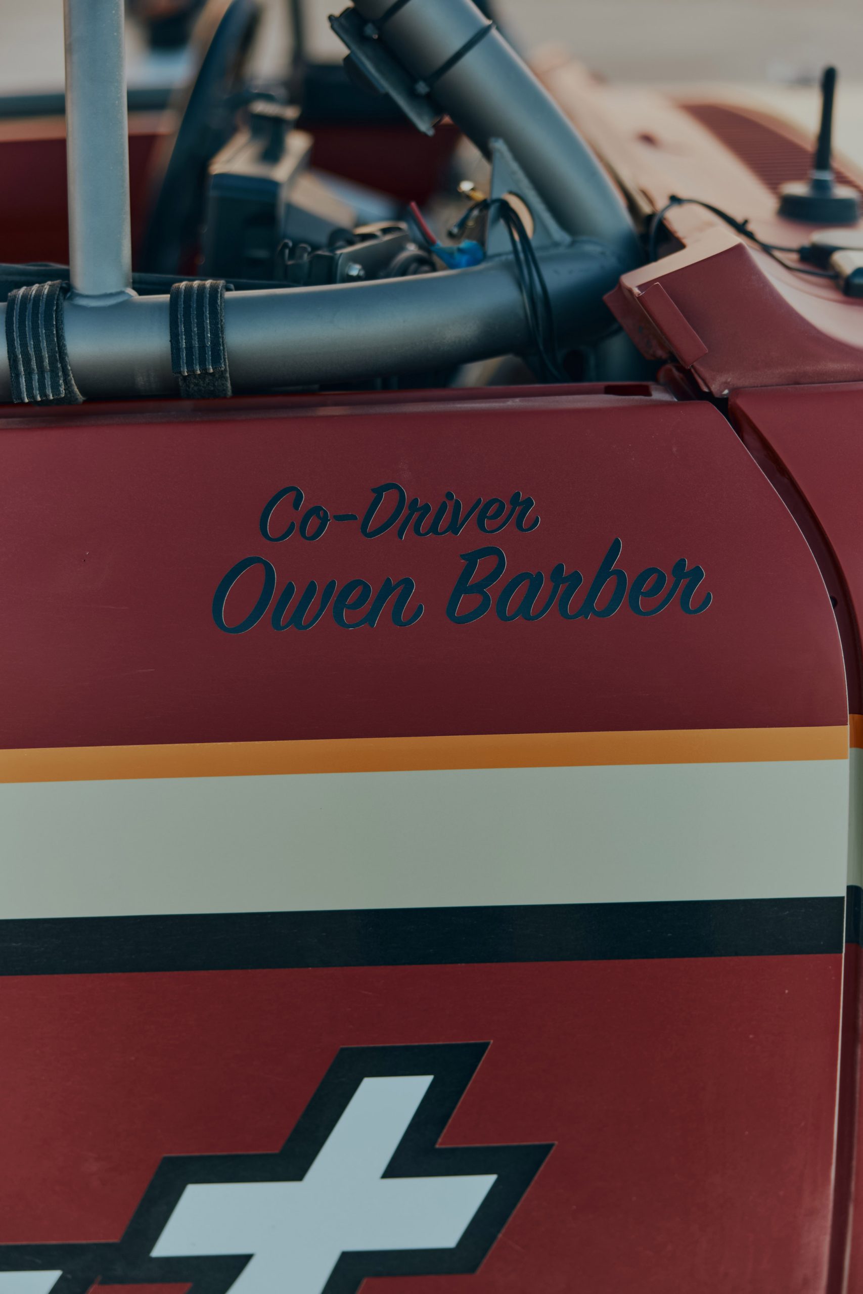

The busted roll cage has been rebuilt by Safari Technologies in California, with chromoly tubing in the mix for weight savings, plus anti-intrusion bars to protect the occupants better.

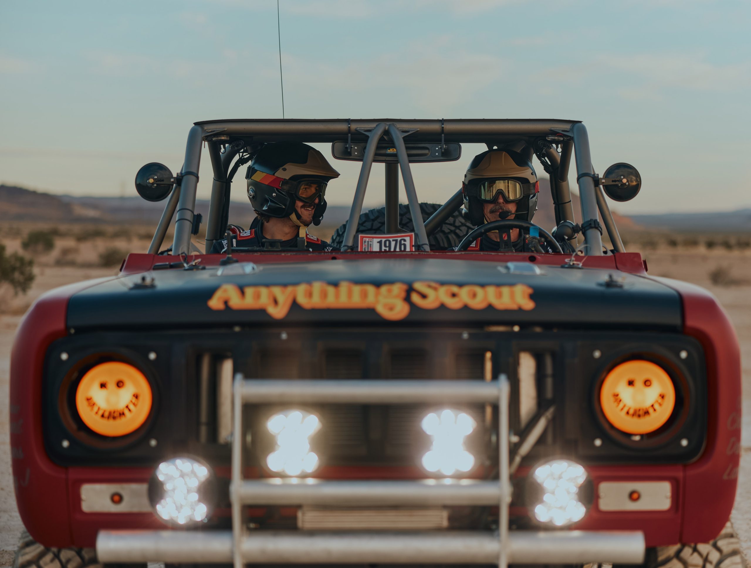

On the performance side, Sean has increased the compression ratio on the 196ci engine and installed a camshaft with a custom grind—which should add an extra 20 horsepower, or more.
He’s also replicated an early trick the factory race trucks used: a single-speed all-aluminum TC-143 transfer case. “No more low range, but we save 37 pounds,” Sean notes. “We also switched the close-ratio transmission to a wide-ratio T-19 four-speed.”
The new Borg-Warner ‘box will harness the higher RPM capacity of the new engine better and compensate for the loss of the low-range transfer case.
The suspension moves up a level too. Sean has installed two-inch single shocks from Radflo®, made in Southern California. “The dual shocks were great, but we were able to save over 50 pounds by going to single shocks,” he explains. “We’ll see if this was the right call!”
It’s a philosophy that was espoused by Lotus Cars founder Colin Chapman, who famously said, “Simplify, then add lightness.” The mission to save weight even extends to the bodywork: the Anything Scout crew have removed the Terra top and windshield frame for this year’s race. That saves another 50 pounds or so and radically changes the look of the truck.
“Trying to save weight while maintaining safety is the key,” Sean says. “After adding more power, we feel this Scout [racer] will be the best yet. Scout trucks were—and are—tough, well-built, and simple machines. We wanted to honor that heritage and pedigree.”

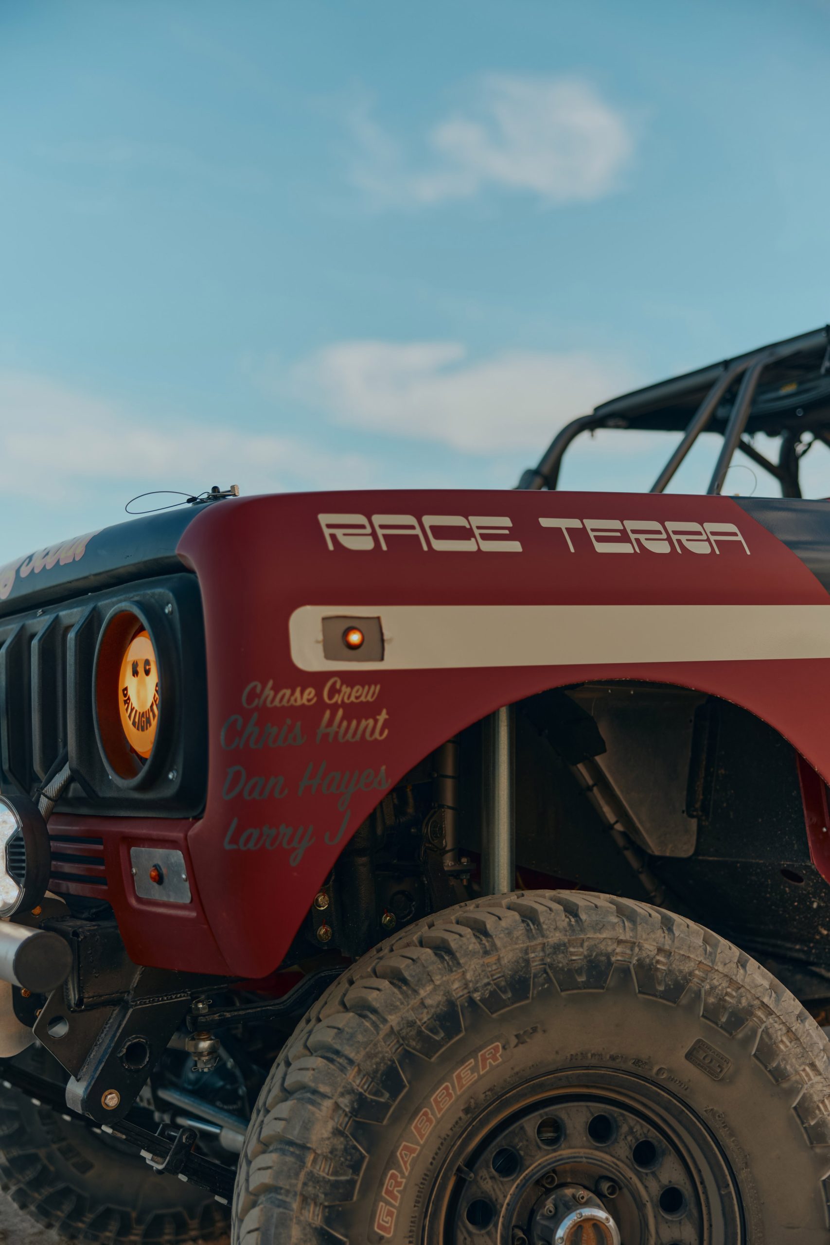

To get the best possible graphics package and livery, Sean has partnered with the Scout Motors design team. “We’re changing the color,” he says. “We wanted something vintage in style, that would also ‘pop’ against the Baja desert terrain.”
To add some style to the vintage racer, Sean and the Scout Motors design team partnered up to work on the color and graphics. The truck is finished in a Terra Cotta burnt orange that pops in the desert landscape and is also inspired by the new Traveler™ SUV’s color. “We pulled inspiration from Scout [vehicle]’s racing history,” says Ray Ng, Director of Brand Experience Design for Scout Motors. “We then blended it with NORRA flavor to create a modern look for the race.”
